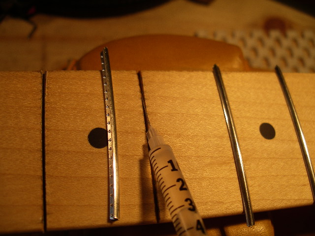

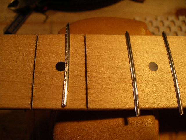

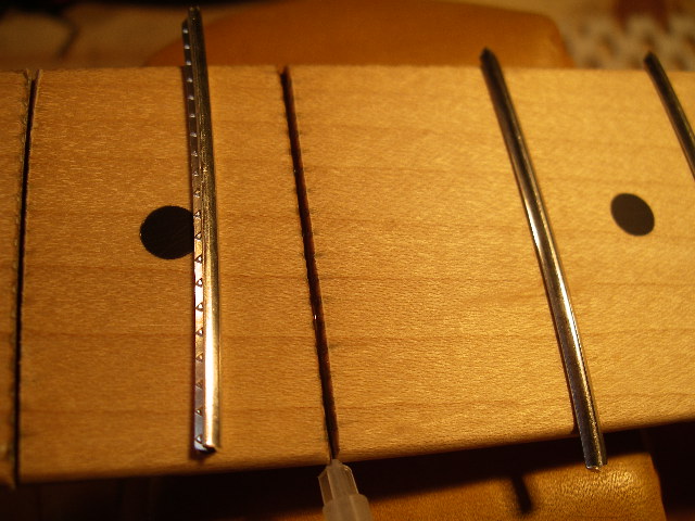

just thought i'd share a mini-tip that saves me time in the repair shop.
when using med/ thick CA to glue frets in, getting it in the slot perfectly can be tricky from the bottle.
Try the local chemist for insulin hypodermic needles, pull out the plunger and drip in your glue from the bottle. It just about allows itself to be pushed through the needle.
Makes it really easy to get a full amount of glue in the slot with approx 5 seconds clean for the whole neck - if any.
Not exactly going to revolutionize the trade, but when i've sanded a board down before installing frets it never quite looks 100% if you have to scrape glue off.
appologies to all those who've been doing this for years - i've just not seen these little needles used before. I have the larger glue syringes and teflon pippets but these are great for getting CA under frets, into neck splits etc etc . they cost very little too, disposable in fact.
pics:
love having no clean up!
all the best,
steve
